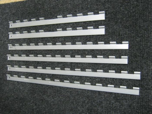

Match drill hinges for seat back braces
Removed center eyelet on F1237H. Cut to length & drilled pilot holes on F1237F (FWD, AFT) & F1237H,

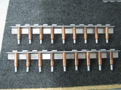

Match drilled F1237F aft, using F1237G seat back brace, L&R

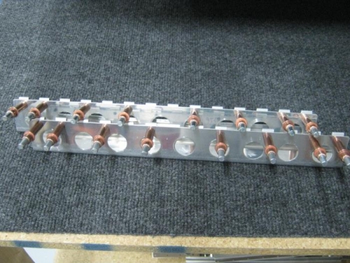

Match drilled F1237H, using F1237D lower seat back angle, L&R
