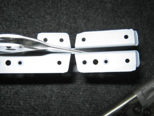

Steps 1 & 2
Final drill #19 nut plate holes
Dimpled the indicated attached hole for the MS21051-L08
