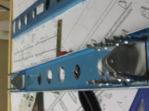

Brief Description:  Clecoed the front and rear spars
Clecoed the front two spars (HS902) to the spar doubler plate (HS907) and match drilled with #30 drill bit.
Clecoed the rear two spars (HS903) to the rear spar doubler plate (HS906) and match drilled with #30 drill bit.

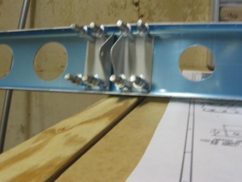

Clecoed the eight (8) outboard hinge brackets to rear spar sub-assembly and match drilled with #30 drill bit.
