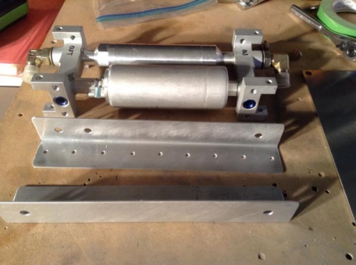

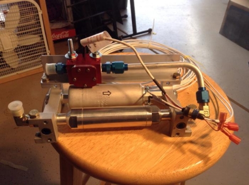

The EFII electric fuel pump installation was relatively painless. I would rather not place this system in the fuselage for maintenance and leak reasons, but I cannot see another place for it on the RV-8. I will not install the top over plate since I put the fuel flow transducer in this location.
mounting brackets are not supplied
"Red Cube" fuel flow transducer
Installation complete
