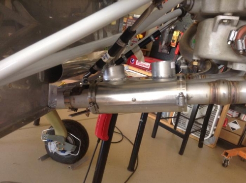

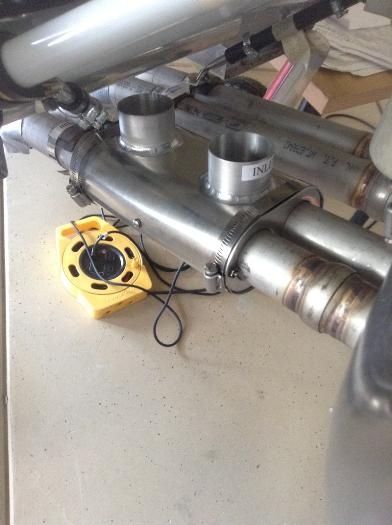

Brief Description:  Heat muff installation
Standard dual-pipe heat muff installation. No significant issues, although I believe the heat muff would be more effective if it could be installed closer to the cylinder exhaust ports. Tubing installation still to come.
Note the exhaust brackets... Vetterman supplies nice, curve, fitted supports on the top side of the pipes, but only flat, rectangular lower supports. I plan to replace the lowers with another set of the upper style.
Lower exhaust support brackets will get replaced with curved, fitted ones to match to upper supports.
