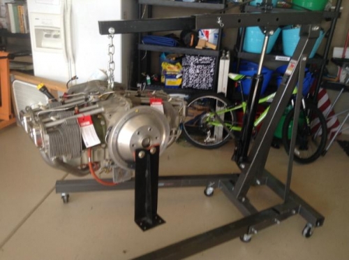

My good friend and fellow RV-8 builder Mark Dickens helped me hang the engine. I broke this process down into 3 phases:
1. The takeoff. Easily done with an appropriately rated engine hoist.

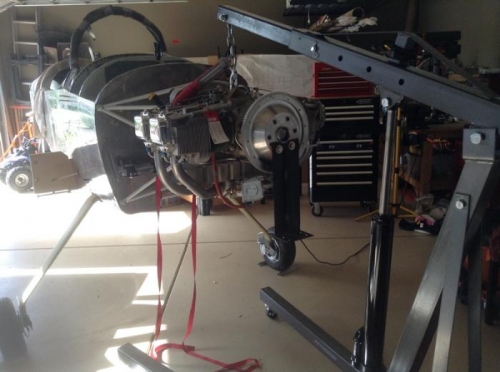

2. The approach. Easily done with the integrated hoist wheels

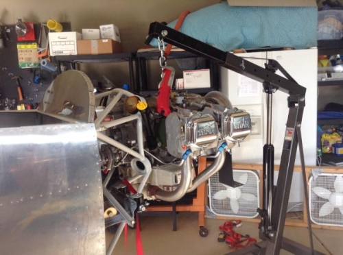

3. The landing. Not easily done. Think severe cross-winds to a bumpy, FOD plagued runway.
There are many techniques on VAF with more in-depth reports than what I'm putting here, but basically I followed the technique of inserting the top mounting bolts and then use the hoist to slightly lift a portion of the weight of the engine to align the lower mounting bolt holes. I used scrap bolts ground to a smooth point as inserts first to get the alignment and then replaced each with the actual bolts. I used the plans specified castle nuts and cotter pins. Others have replaced the nuts with metal locknuts.
The takeoff
The takeoff
The approach
The approach
The landing (lower bolts still to go...)
