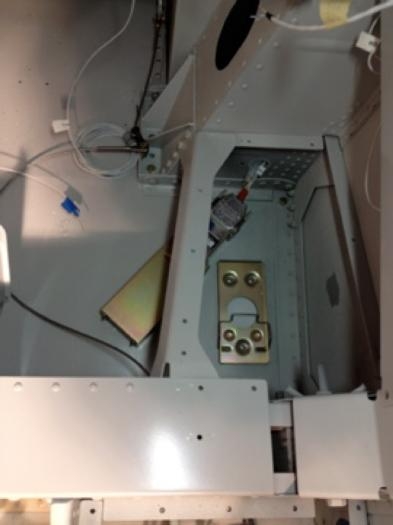

Brief Description:  Transponder install
Mounted the Trig TT22 Mode S transponder in the floorboard under the starboard mid-cabin cover (opposite side of where the fuel selector valve is located). The transponder comes with a mounting tray that has a single spring-type hold down latch. The mounting tray is pop-riveted on top of a backing plate to the floorboard

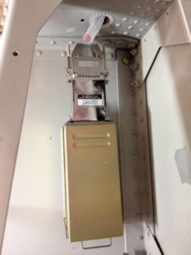

The only issue so far with this configuration is that I didn't realize just how long the GRT adapter is, so there is a quick turn required in the wiring harness. It's not shown here, but mounted an adel clamp to a short piece of angle bolted through the tooling hole adjacent to the wiring harness grommeted hole. A slightly better plan would have been to mount the tray angled to match the wiring hole vice parallel to the longeron.
