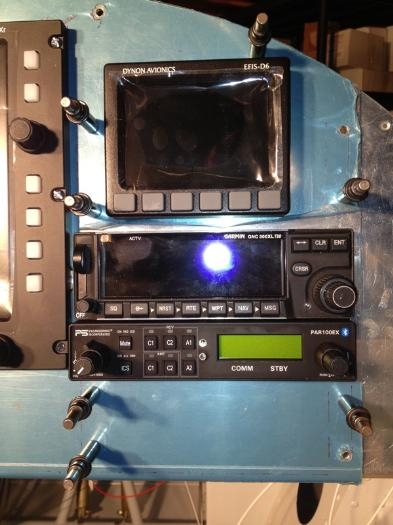

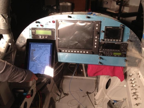

Still working through cutting the instrument panel to mount the avionics. There are still switches, indicator lights, vents, etc to go into the panel, but the main boxes are shown here. i show an iPad help in place, but this will most likely be replaced with an Android tablet that will communicate via Bluetooth with the HXr MFD shown. My plan is to also mount a tablet in the back seat for a glass panel repeater of the HXr PFD information.
Also shown is the radio stack and BFD. The BFD is the Dynon D6 unit with self-contained AHRS (essentially the third attitude reference system). The Garmin 300XL will function as com 1 and certified GPS nav, and the PAR 100EX will function as com 2 and audio panel.
