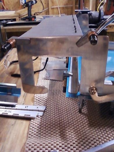

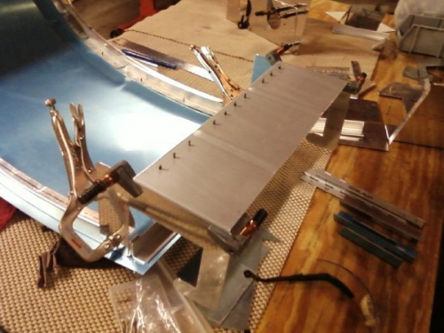

Brief Description:  baggage door hidden hinge brackets
cut and initial fit of forward baggage door hidden hinge brackets. fabricated a supporting cross member with sheet and angle to provide some rigidity to the hinge assembly. the brackets are a little larger than i expected they would be, an on reviewing john huft's plans, i did accidentally make them larger by about a 1/2" in one dimension. the only issue there is that it may get in the way loading baggage.
