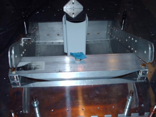

finished locating and drilling the bolt holes for the f837 control column hanger. this part rests on two spacers and is secured through the floorboards and floor ribs via nutplates.

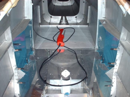

also fit and drilled the aft cabin covers to the bulkhead and floor. just need to trim the top edge along the aft armrest and then match drill to the armrest flange to complete the covers. these covers will hide the flap actuator.
f837 with attach bolts inserted
aft cabin covers drilled to floor & bulkheads
