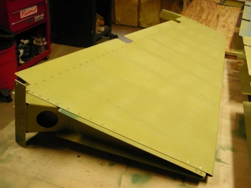

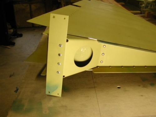

finished the pop rivets on the rudder horn to complete the rudder skeleton. riveted the skeleton to the skin. the night prior to riveting i put a daub of rtv sealant at the aft end of each stiffener to tie/bind them together. this is supposed to help prevent trailing edge skin cracking. i did this on each elevator as well.
pop rivets in rudder horn
skin riveted on
skin riveted on

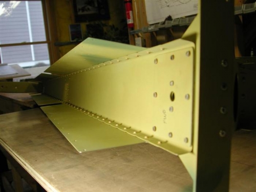

view of rudder spar. notice the flutes?
