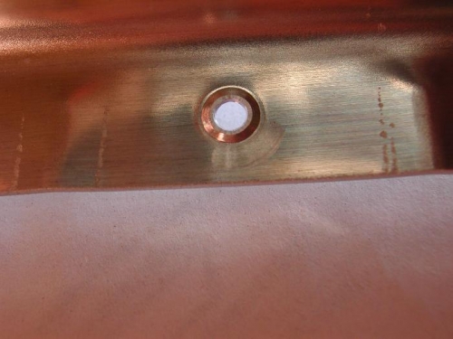

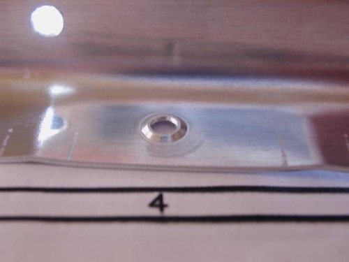

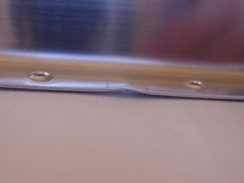

Had an issue with the rudder spar too when dimpling. Evidently I had the squeezer too tight when I dimpled the spar and it did the opposite of fluting and put a bow in the spar. I freaked out and thought I had just bought a new spar and all the repeat work that goes along with that, but after speaking with the guys at Van's, we agreed to try to flute the spar and straighten it. Worked perfectly. Some pics below.
