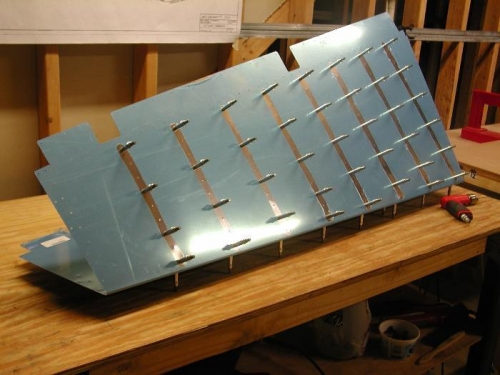

Brief Description:  Rudder skin stiffeners
I began work on the rudder. The stiffeners are a good place to start here, so I cut them to length from the supplied angle and trimmed so they would fit in the folded trailing edge. I then match drilled them to the skins. After deburring, I dimpled all the stiffeners.
