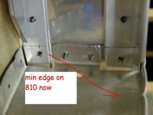

redid the 702 spar, 810 reinforcement bar, and 405 middle rib.
all parts came out very nice this time.
the plans for the -7 go a little more in depth in this area and were more helpful than the -8 plans. namely, discussing the bend relief holes in the spar and in locating the 405 to spar to 810 holes.

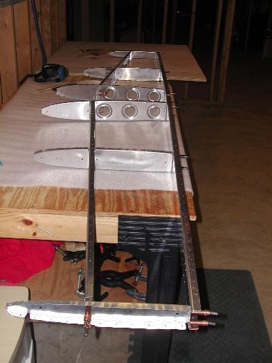

all parts have good edge dist this time. clecoed everything back together for check prior to riveting.
ready for dimple, prime, and rivet.
