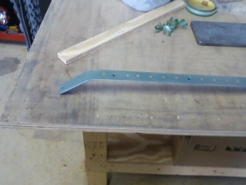

more work today setting up shop in the hangar.
spent some time looking through the plans and getting back into the "flow" of things.

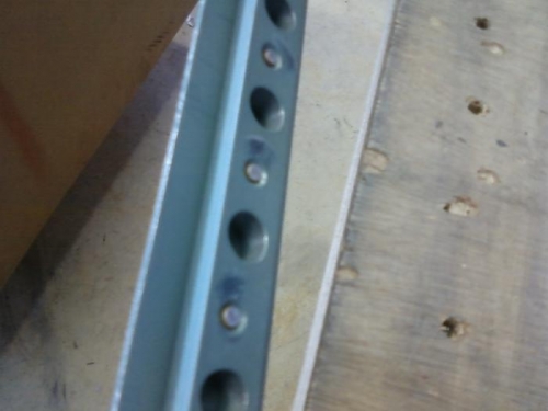

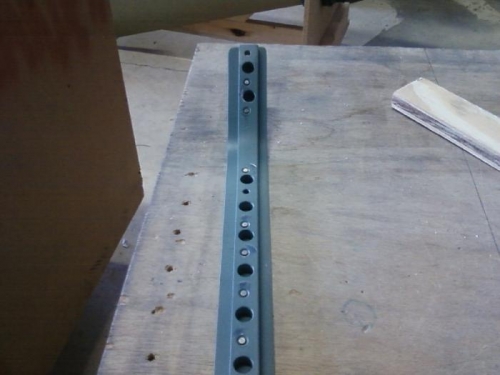

d,c,p (debur, clean, prime) the canopy slider rail C-805 & C-805. then double flush back-riveted the assembly. the shop head sure seems small sitting the countersink. the rivet callout was double checked, but the shop head appears to only fill half (or maybe even less) of the c'sunk hole. see pics.
then i taped the slider rail into position on the turtledeck and will drill the fasteners holes during next session.

shop head looks quite small in the c'sink
some blemishes from back riveting
