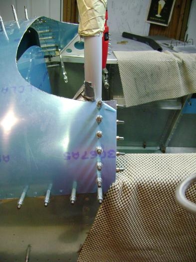

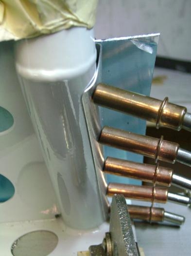

Brief Description:  rollbar attach
fit rollbar to fuse and drilled the 6xside bolt holes through the longerons. also match drilled the f8104 top skin support brackets to the rollbar. this took an amazingly long time as i had to remove and reassemble the f821 top skin a few times for debur and to work with the rollbar fit up.
