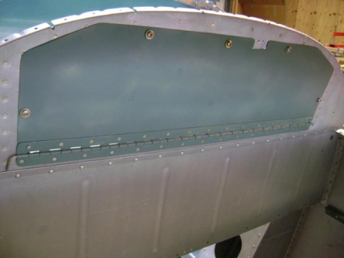

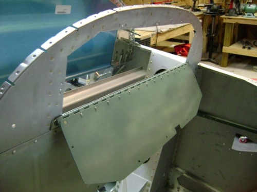

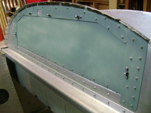

completed the instrument access panel. cleaned, scuffed, cleaned again, and primed the reinforcing plates, the hinge, and the door. riveted same, installed nutplates and screwed the door shut.
not sure if the hidden bag door hinge is going to work with this access panel.....
