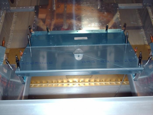

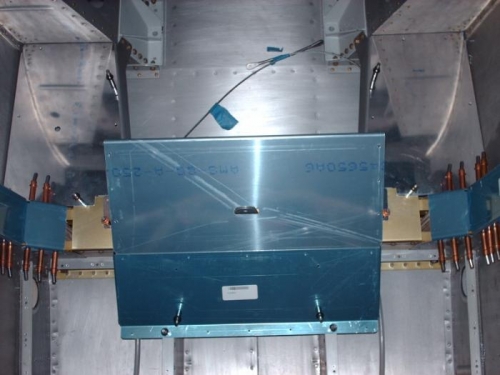

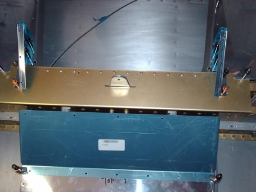

after working on the fuel selector valve and the mid cabin covers, i fit the front seat ramp. this required inserting the center floor panel and match drilling the f879, f880a seat ramp, and the f880b ramp ribs.
looking forward
looking aft
ramp ribs
