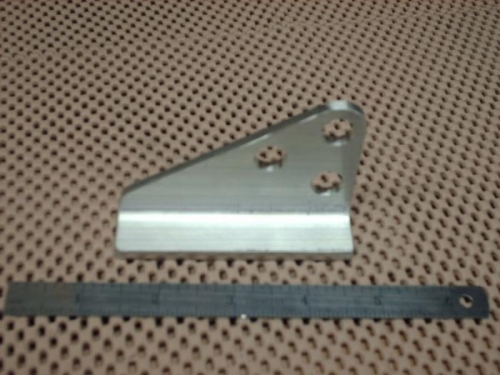

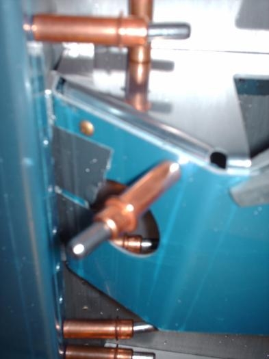

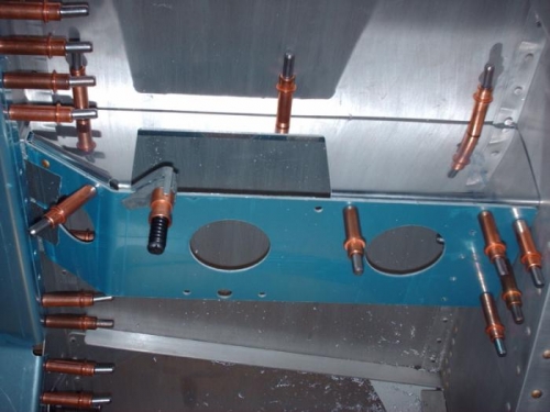

Brief Description:  throttle quadrant
returned from navy det to puerto rico and vacation to hawaii. finished up throttle quadrant. had to fabricate the f864e cable anchor. also fit & drilled the quadrant to the f804 channel bulkhead. i had to use a spacer to make the rear face of the throttle quadrant sit flush with the bulkhead. not sure if others have had the same issue, but mine appears to be due to the non-square f804 channel flanges (ref post on 1/2/08).
