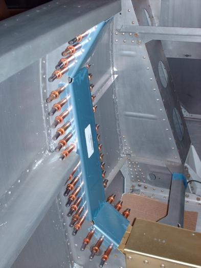

Brief Description:  throttle quadrant & port channel cap
i fit and drilled the throttle quadrant and port spar channel cap. the throttle quadrant seemed to fit well. the spar channel cap not so much. similar to the starboard side, i couldn't find any definition location called out in the plans or drawings. so i attempted to square it all up and drill it. however, the spar channel flanges are not straight nor 90 deg to the web, and the surface to which the spar channel cap will be riveted (where i had to drill today) is wavy. the outcome is a channel cap that doesn't fit perfectly. again, this is cosmetic but will be visible from the front cockpit. you can see what i'm talking about in photo 1.
