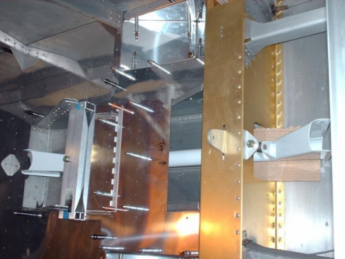

moved on the control column. this is the main control column to which the control sticks are mounted to actuate the ailerons and elevators.

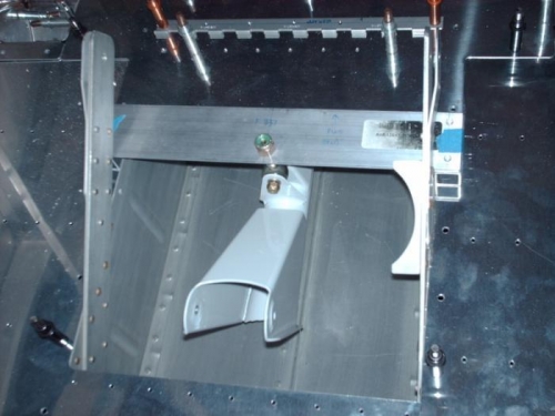

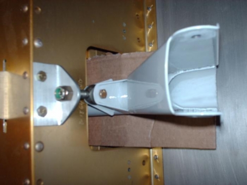

fabricated f837 and 2xf838 to hang the control column. these consist of a length of angle that sits on top of two spacer blocks on top of the floor panel. the control column then hangs from this at its aft end, and from another hanger (f849 - installed already in the quickbuild kit) in the f804 bulkhead.
the control column appears to hang just right and swings freely in the bearings. there is no play fore and aft. i will wait to torque these up until after painting and final install.
control column - fwd end is to the right
forward hanger
forward hanger
aft hanger
aft hanger
