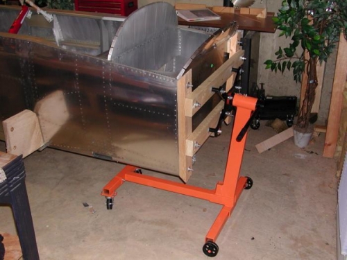

Brief Description:  fuselage rotissiere stand

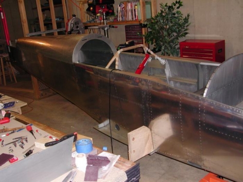

worked on fuselage stand. bought an engine stand from harbor freight. using lumber to mount via 1/4" bolts through engine mount holes in the firewall to make a rotissiere stand. this will allow much easier access to fuse interior than climbing in/out. i installed the tailwheel spring and used a ratcheting cargo tie-down strap to support the aft end from a header in one of the framed basement walls. the lumber in the lower, left corner of photo 1 is the false spar that is installed at the factory for shipping.
engine stand mounted to firewall
aft end supported on tailwheel spring
