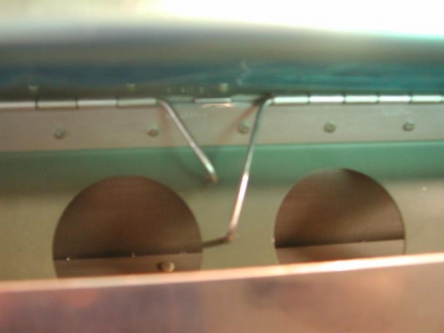

Brief Description:  starboard flap hinge
fit starboard flap hinge to wing. cut center access for hinge pins. removed two eyelets at center of hinge and cut hinge pin into 2 lengths. this allows for install & removal from the center of the flap and prevents the need to go through the aileron bracket. drilled and inserted the hinge pins into the flap brace for security.
