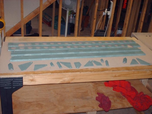

Brief Description:  flap brace and aileron gap fairing
finished match drilling the flap brace and aileron gap fairing to the skins. machine countersunk the flap brace since it is sandwiched between the wing skin and the flap piano hinge. deburred. dimpled the aileron gap fairing, and the wing skins for the fairing and the flap brace. cleaned and deburred everything. primed all parts with SEM brand self-etching spray can primer instead of mixing just a small batch of vari-prime.
