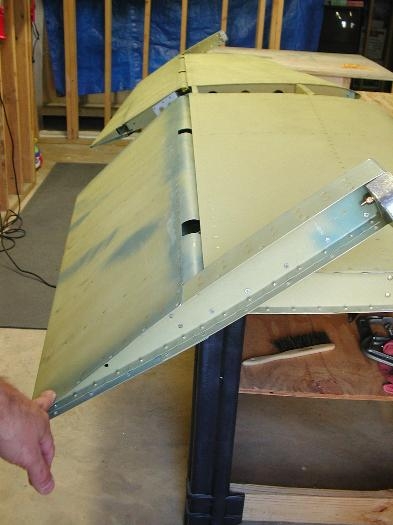

Brief Description:  elevator installation
installed the elevators. had to trim quite a bit of the HS skins to allow for the counterbalance arm to swing through. trimmed about 7/8", but it turned out nice and i have the 1/8" min gap called for in the plans. should be enough room for fiberglass build up.
