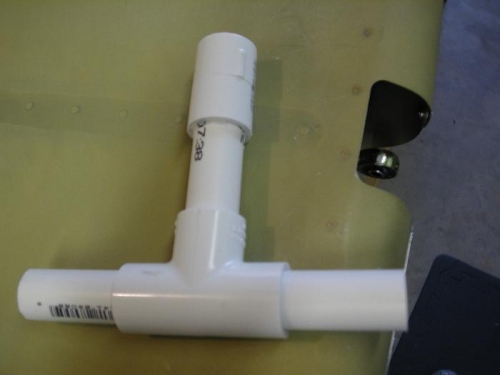

rod end bearing tool
made this tool to thread in the rod end bearings on the elevators and rudder.
idea from sam buchanan's website. it's just 1/2" pvc with slot cut in the business end to fit over the rod end without damaging the bearing or the races.
