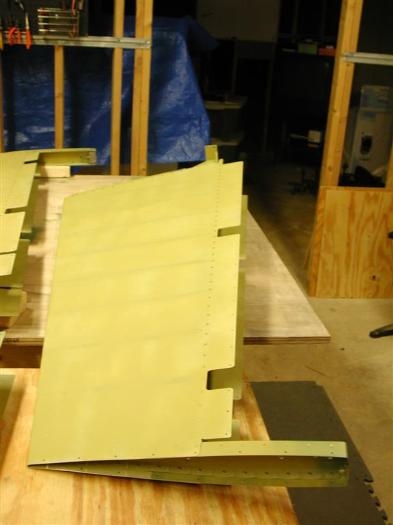

riveted the starboard elevator skeleton to the skin.
added the rtv sealant a day prior and let it cure. this is supposed to help prevent cracking around the ends of the stiffeners due to vibration and fatigue.
starboard elevator skin on

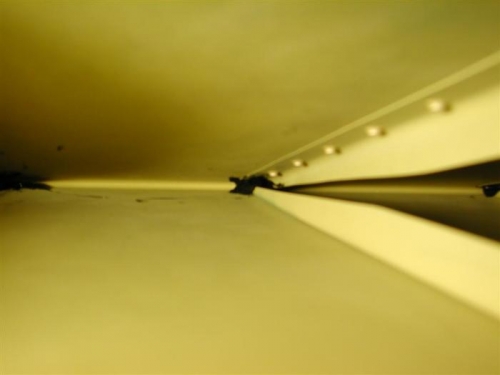

rtv sealant on stiffeners
rtv (and pop rivet in last hole - no room to set a rivet)
