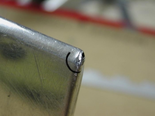

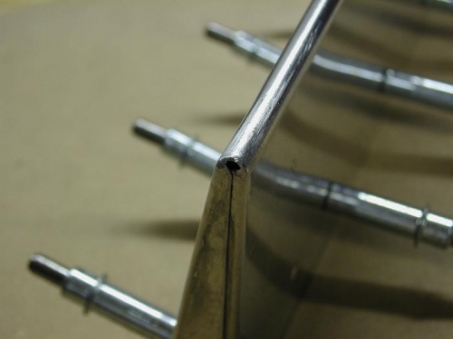

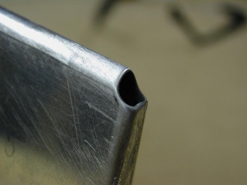

he tabs were tricky to bend and I had to trim the outboard trailing edge corner after bending because the form blocks shifted a bit and the bend line ended up at the edge of the bend relief hole vice the center line of the hole. After trimming though to relieve the stress, the trim tab looked good clecoed. We'll see how it turns out after riveting. It is primered now and ready for final riveting.
bend line not centered on hole
small crack at end of tab
stressers relieved
stressers relieved
