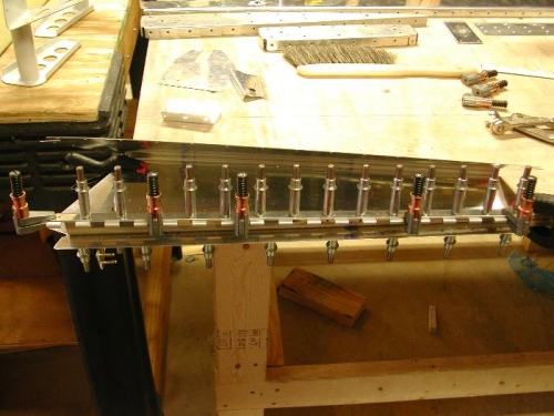

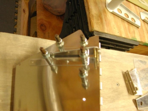

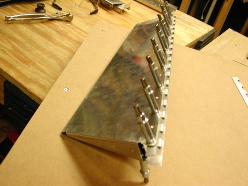

Brief Description:  elevator trim tab
Built up the elevator trim tab. Drilled the trim actuating rod bracket attach holes and matched drilled the spar and hinge. The tabs were tricky to bend and I had to trim the outboard trailing edge corner after bending because the form blocks shifted a bit and the bend line ended up at the edge of the bend relief hole vice the center line of the hole. After trimming though to relieve the stress, the trim looked good clecoed. We'll see how it turns out after riveting. It is primered now and ready for final riveting.
See "elevator trim tab part ii" for photos.
