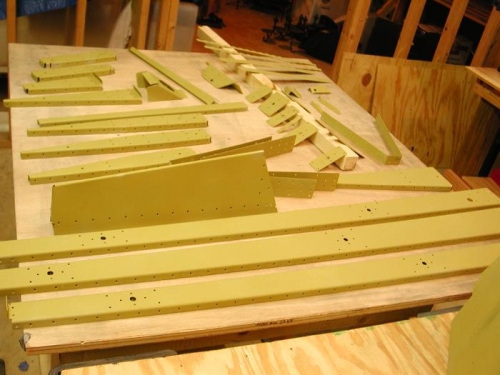

Date:  1-1-2007
Number of Hours:  3.00
Brief Description:  primed rudder & elevator
Started the new year off right by getting some work done. Cleaned rudder and both elevator parts w/ acetone to remove oils, geases, fingerprints, etc and sprayed Vari-prime 615 self-etching primer.
The darker colored areas visible on the skins are areas touched up w/ self etching spray can primer (SEM brand from Auto Color) when I have small localized spots, pre-riveted lines, etc and don't want to mix a whole batch of the two part stuff.
