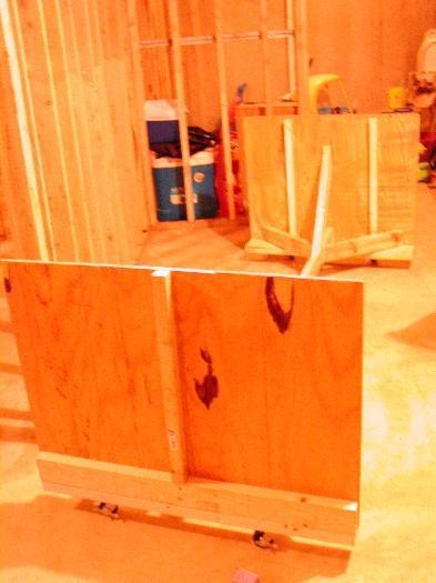

With the QB wings due to arrive in a few days, I decided to get the cradles built up.
I used scrap plywood, 2x4's, and some casters to construct a moveable wing cradle.

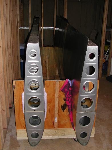

Without a nose rib to pattern, I built the cradle and then made the cutouts after the wings arrived. I made a cardboard template while the wings were still in the truck and then cutout the leading edge profile with a jig saw. fit was ok, but would have been better with a rib to pattern after.
prior to leading edge cutout

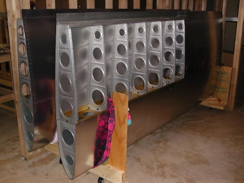

wing interim resting place
