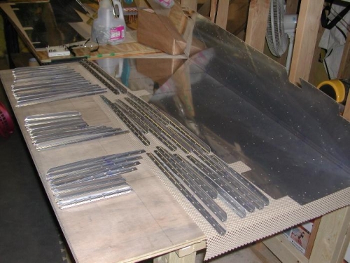

Finished dimpled the left & right elevator skins and the remainder of the stiffeners.
The skins are done mostly with the C-frame dimpler, but the folded trailing edge makes it tough to get to the last few trailing edge rivets. For these I used the pop-rivet dimpler tool from Avery. The dimples came out very nice, and comparable to the c-frame dimples (this is .020" skin...)

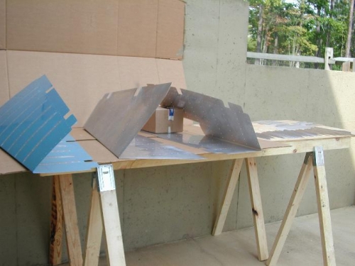

I also prepped the parts for priming by cleaning, scuffing up with a fine scotchbrite pad, and then cleaning again with acetone to remove all oils, inks, fingerprints, etc.
all those stiffeners, all those dimples...
you can see the skins scuffed via scotchbrite pad
just prior to priming
