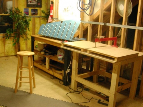

Date:  9-19-2006
Number of Hours:  3.00
Brief Description:  Rudder skin dimpling
Finished dimpling the rudder skin. The dimples along the folding trailing edge are difficult to reach. I had to do them with Avery's pop-rivet dimpler tool. The dimples came out almost exactly like the ones punched with the C-frame but the process is considerably slower.
