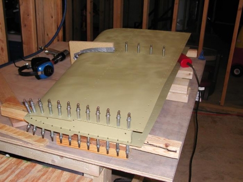

Riveted the HS 707 nose ribs today. Had Swami helping out and this is a requirement for these ribs. It is much, much easier to set good rivets with two people due to the reach involved. All the rivets came out nice except for two of the forward most on the starboard side. Drilled those out and will reset them tomorrow.
port 707 rib riveted
