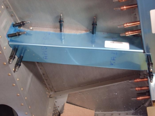

Date:  12-29-2007
Number of Hours:  3.00
Brief Description:  starboard console & channel cap
fit and drilled the starboard console and the spar channel cap. the parts all seem to fit well clecod together, but i was apprehensive about putting holes in metal b/c the plans don't seem to give much information on locating the parts - especially the channel caps. i ended up just making sure everything was square and flush and then drilled the parts beginning with the 3/4" angle that gets riveted to the skin.
the console will be removeable attached with #8 screws and nutplates.
