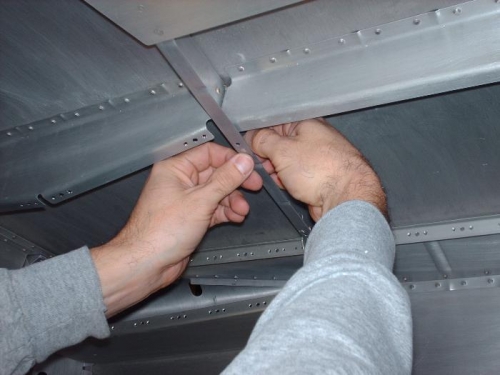

Date:  12-14-2007
Number of Hours:  6.00
Brief Description:  floorboards, control sticks, aft side panels
Removed the aft side panels and deburred the edges and screw holes. This took a while to get a straight edge on the top where it attaches to the armrest. I then removed the control column and prepped the control sticks for later installation. This required final drilling the control column weldment and reaming the bushings to accept the AN4 bolts for the forward and aft control sticks. I removed the floorboards, deburred the stiffener holes and screws holes, and then dimpled the floorboards and rear seat footwells.
