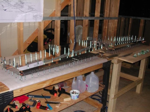

Brief Description:  match drilled skeleton (and oops...)
clecoed skeleton together. drilled rib to spar attach holes.
clecoed on skins.
attempted to locate hole on 404, 405, 810 and 814.

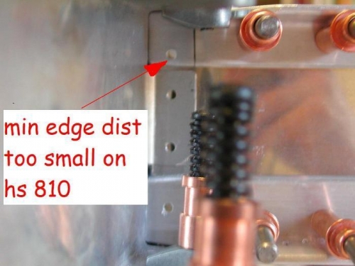

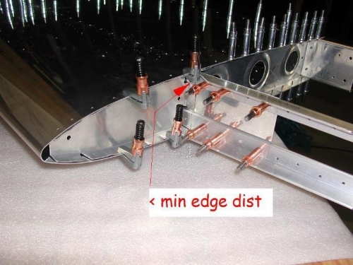

topmost hole on starboard side attaching 405 to 702 to 810 to 404 did not have proper edge clearance. you really must cleco the whole thing together and take a number of measurements before drilling.
plans stress to maintain edge distance on 405. better to watch carefully for edge distance on 810!
ordered new 810, 702 spar and 405 rib.
topmost hole below min edge distance
