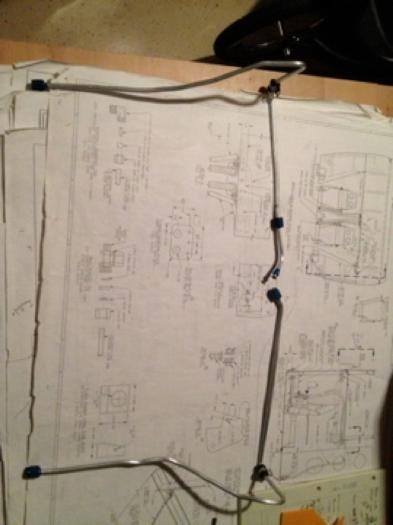

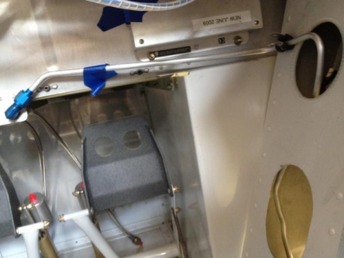

Brief Description:  Brake lines - fuselage - part 1

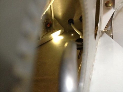

Fabricated the brake line segments that run through the fuselage. These start from the end of the flex line from the fwd baggage bulkhead and run outboard and then down through the gear towers to a bulkhead union at the gear attach points. This was a pita working down through the gear towers. Not sure Van could have design a more difficult area to work than those gear towers. Used the plans specified 3032 tubing.
this line shown hanging freely
looking down into gear tower
