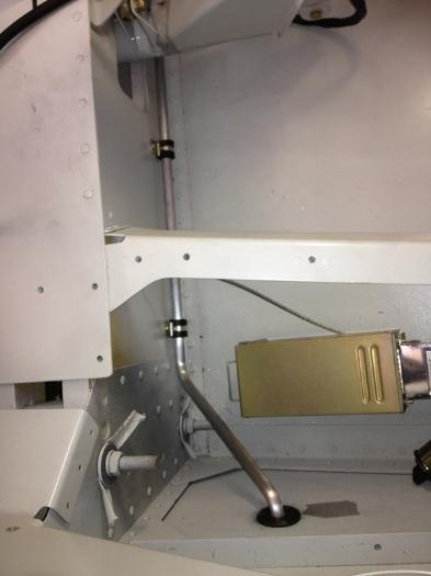

Brief Description:  Fuel lines - fuselage
Began the fuselage fuel line work. I am using O-5052 tubing in place of the 3032 tubing in the plans. The 5052 tubing is a harder material and purportedly results in stronger, more durable flares. The fuel line fabrication is an iterative fit/bend/trim process using rough dimensions from the drawings as a starting point. I used wire coat hangers to get rough templates.
might change from Van's fuel selector later
gold box is remote transponder

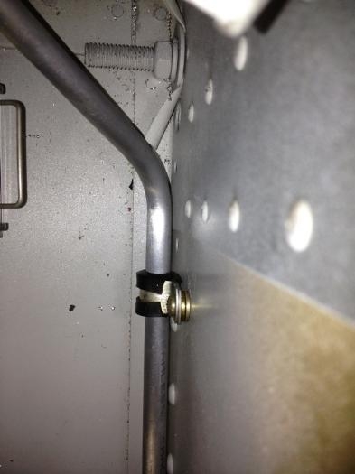

2 washer standoff
2 washer standoff
