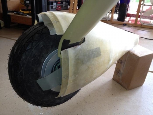

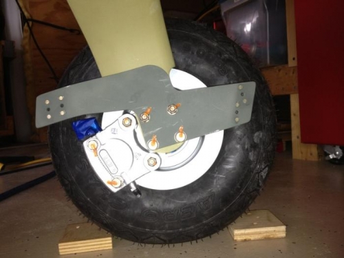

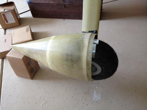

Mostly finished with wheel pants installation. Installed platenuts to attach brackets and final drilled fairings. Remaining is to rivet to U808, countersink for tinnerman washers, then prep/paint finish work.
