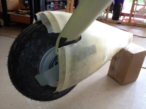

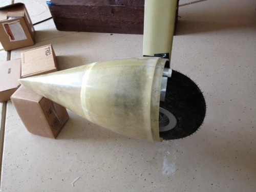

Brief Description:  wheel pants part 2
Wheel pants work continues... drilled the U808 and aft tab of U807. Used a laser to align the fairing with the tire tread ("vertical alignment) and measured the aft end to be 1-5/8" higher than the wheel axles centerline (horizontal alignment) per plans. This aligns the fairing with the wheel versus the "earth" which puts the fairings parallel to the fuselage in flight and aligned with the tires when weight on wheels.
