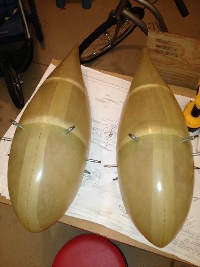

Date:  6-24-2013
Number of Hours:  3.00
Brief Description:  wheel pants part 1
Began wheel pants instal. Began by prepping the forward (VA-157A) and aft (VA-157B) fairing halves by fitting together then trimming to improve fit. After many fit/sand/fit iterations, the fairings mate together pretty well. Next, the 7 holes were drilled for the fwd-to-aft attach screws. A centerline was then marked along each fairing, although this was quite difficult and arbitrary at best. I did this by eyeball as the only real measurement I could determine was based on the wheel opening and who knows how accurate that is.
