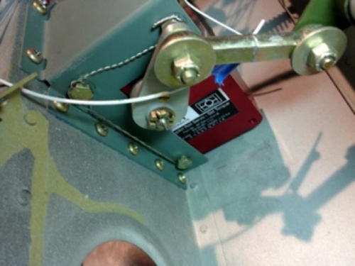

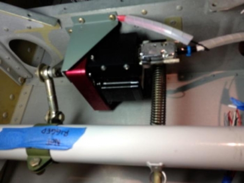

GRT roll servo part 2
GRT autopilot roll servo installed with all hardware (including failure capture large washers), safety wire, and electrical harness. The pushrod and mating clamp will be final assembled during the final control rigging process.
