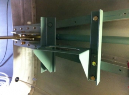

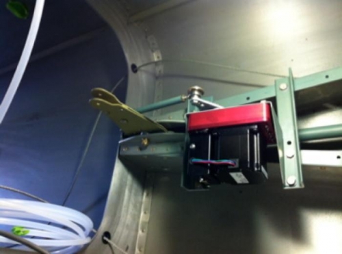

Date:  10-1-2012
Number of Hours:  6.00
Brief Description:  Pitch Servo bracket
The GRT autopilot pitch servo has been mounted and wired. There is still some minor clean up work securing the wire harness and final check of servo arm rotational travel limits. This arm shall not travel more than 60* total travel and shall not be capable of rotating over-center. This will be checked during final control system rigging.
