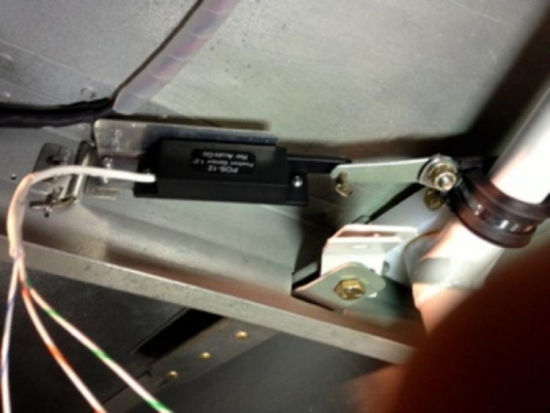

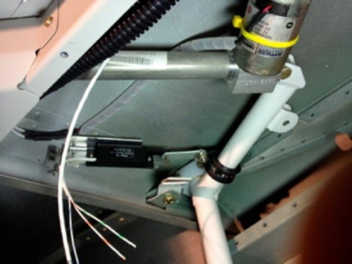

Brief Description:  Flap position sensor
Installed flap position sensor for feedback to VP-X, which provides flap protection and indicators if programmed. This sensor appears to be an extremely delicate piece of gear. I mounted the fixed end of the sensor to a short length of aluminum hinge and the telescoping end to a short length of scrap plate bolted to an adel around the flap actuator rod. This was op checked with a small 9v battery.
The wires have since been bundled and routed forward to the VP-X in the same bundle as the flap motor power wires running under the port arm rests.
