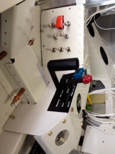

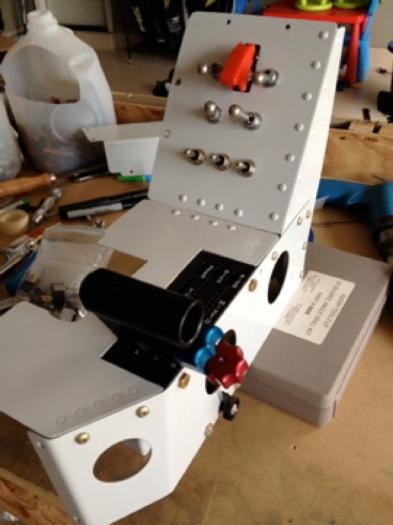

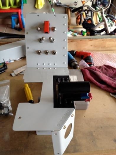

Brief Description:  Throttle Quadrant
Assembled throttle quadrant and temporarily mounted to accomodate wiring harness build up. I deviated from the plans here and made my own quadrant in order to move the throttle aft and also to put the throttle adjacent to a fixed structure. This allows an anchor or reference point in order to make precise throttle movements necessary to fly good formation (or carrier landings!). The other reason for the custom quadrant is for the switch panel. I'll include another photo once it's labeled, but these switches are engine controls and emergency electrical power switching.
