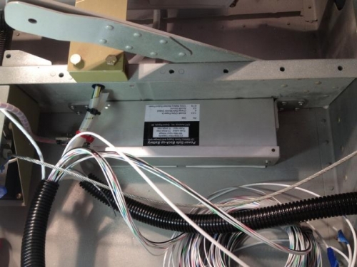

Brief Description:  GRT backup battery
Mounted the GRT backup battery under the floorboard to the port seat rib (stringer) adjacent to the front seat belt anchor. This will provide emergency power to both AHRS units and the HXr PFD. The charged state of this battery will be available via the EIS.
