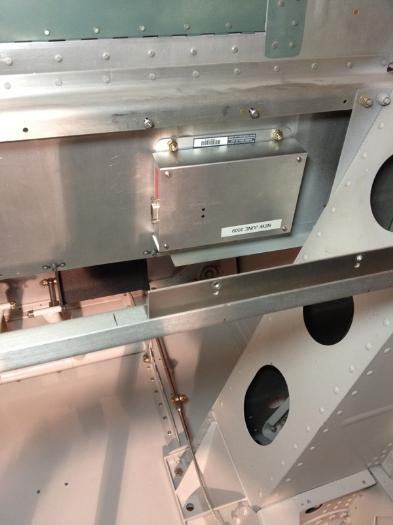

Brief Description:  Garmin battery
Mounted the Garmin backup battery via 4 screws to the starboard, lower aft wall of the fwd baggage compartment. The unit weighs next to nothing and has a single dsub connector on the inboard face. This will provide emergency power for a com radio and GPS nav.
