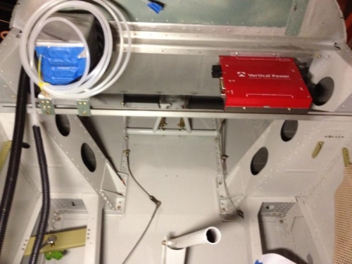

Brief Description:  VP-X mounting
Mounted the VP-X Pro to the fuselage cross braces opposite of the AHRS units. In hindsight, I should have mounted this unit on the centerline of the aircraft to allow more room for wiring harnesses. This area is crowded with the BFD and radio stack above it. The VP-X can be mounted anywhere in the airplane, with the obvious requirement to protect it from water intrusion (the box is not sealed).
