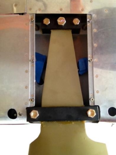

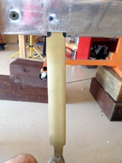

Number of Hours:  10.00
Brief Description:  gear leg final torue
took 2 interations to get final install of the gear legs. on the initial fit, the U-803 brackets bottomed out on the wear plates prior to achieving the plans specified torque of 240 in.lbs. i removed the legs and machined down the face of one end each of the left and right U-803s and reinstalled. upon retorquing the bolts, i achieved the specified torque and the specified .030" gap. all is well now, but this was a difficult task working inside the gear towers.
next step is to install the axles, wheels, and brakes.
